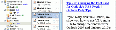

A user disliked Calibri font and wanted to change it but gave up after changing fonts "everywhere" in both Outlook and Internet Explorer and not affecting the RSS feed font. He posted the question in a forum and no one there knew either, so I asked the people who worked on the RSS feature at Microsoft. The answer: The font is not exposed to end-users.
The user thought that maybe it would be possible to do it using a Run-a-script rule but had no idea how to write the script. Outlook Developer MVP Michael Bauer of https://vboffice.net/ supplied the code to make it work. (Michael has quite a few useful code samples on his site BTW.)
We first check the message source so we can see how the font is set.
Because its hard-coded in the message, changing fonts in Outlook won't help; we need to change the message source. Fortunately, a run a script rule can change it.

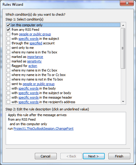

Next, you'll create a Rule that applies to any RSS feed, with the Run a Script action, selecting the ChangeRSSFont macro.
Use a Run a Script Rules to change the font
As new RSS feeds arrive, the font will be changed from Calibri the font of your choosing (Times New Roman, in our sample).
