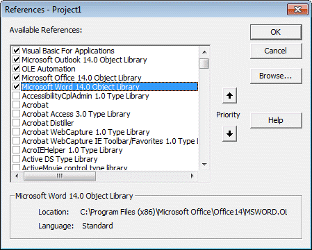

Don't forget to set a reference to the Word object library in Tools > References. Select the correct version for your version of Office. (Most people will only have one entry, the correct one.)
Set the VB references

    Then highlights this line "Dim wrdApp As Word.Application"
    Suggestions?
      September 20, 2016 at 3:51 pm
      Did you set a reference to the Word object library in Tools > References?

      strToSaveAs = "D:\my stuff\folder\" & sName & ".pdf"

    When i trigger the rule, it the VBA will have compile error: User-defined type not defined.
      July 14, 2015 at 1:07 am
      Forgetting to do this will cause that error:
