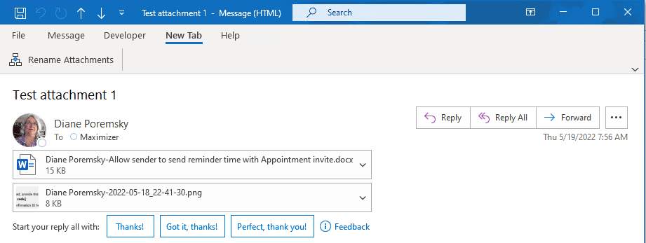

This macro allows you to rename attachments on incoming or outgoing messages.
To rename attachments on incoming messages, open the message in a new window then run the macro.
To use with outgoing messages, open the message in a new window and run the macro.
As written, there are three options for renaming:
  1. The user enters a new name
    dialog box to enter new name
  2. The current date is added as a suffix
    add suffix to attachment name
  3. The senders name is added as a prefix
    sender name added after running macro
When automating the filename change, you can use any value available to the macro, including the sender's name, received date, current date and time, or you can hard code a word to use.

Rename Attachment Macro
Public Sub RenameAttach()
Dim Item As Outlook.MailItem
Dim objAtt As Outlook.Attachment
Dim strExt As String
Dim saveFolder As String
Dim enviro As String
Dim strOldName As String
Dim strNewName As String
Dim iCount As Long
enviro = CStr(Environ("Temp"))
saveFolder = enviro & "\"
Debug.Print saveFolder
Set objApp = Outlook.Application
Set Item = objApp.ActiveInspector.CurrentItem
iCount = Item.Attachments.Count
For i = iCount To 1 Step -1
Set objAtt = Item.Attachments.Item(i)
' get the last 5 characters for the file extension
strOldName = objAtt.DisplayName
strExt = Right(strOldName, Len(strOldName) - InStrRev(strOldName, ".") + 1)
'get the file name w/o extension
strCurrent = Left(strOldName, InStrRev(strOldName, ".") - 1)
Debug.Print strCurrent, strExt
'do not type the extension
strNewName = InputBox("Current Value: " & strCurrent, "Rename to", strCurrent)
'if you click cancel, stop the macro
If StrPtr(strNewName) = 0 Then Exit Sub
' suffix
'strNewName = strCurrent & Format(Date, " mm-dd-yyyy")
'Debug.Print strNewName
' prefix
'strNewName = Item.SenderName & "-" & strCurrent
' put the name and extension together
file = saveFolder & strNewName & strExt
objAtt.SaveAsFile file
objAtt.Delete
Item.Attachments.Add file
 Set objAtt = Nothing
