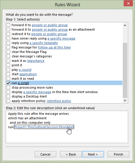

Use a Run a Script rule
To use the run a script rule, create a rule.
Select the has an attachment condition and any other conditions you want to check. The only action will be run a script. Set exceptions as needed.
Use a run a script rule to filter mail
If you need to do more actions, such as mark the message read, forward a copy, etc, you'll need to add it to the script.
To check additional file types, use 4 characters for the extension name. If the extension is 3 characters, use the leading dot in the Select Case list: docx or .doc
Run a script macros will work in ThisOutlookSession but should be placed in a module.

  15. B-rad says
    July 3, 2014 at 2:49 pm
    I am using the code you posted above for the MoveMail macro. The code works for me sometimes and other times I receive a Run-time error stating, "Cannot move the items." I've done some research, but I'm not able to find any solution. Any help is greatly appreciated.
    Thank you in advance.
    P.S. the error I'm receiving is "Run-time error '-2147352567(800200009)': Cannot move the items."
    the code I'm using is below:
    Sub MoveMail(Item As Outlook.MailItem)
    If Item.Attachments.count > 0 Then
    Dim attCount As Long
    Dim strFile As String
    Dim sFileType As String
    attCount = Item.Attachments.count
    For i = attCount To 1 Step -1

      July 3, 2014 at 8:51 pm
      The error means something is preventing it from moving the message. What type of email account? How large are the attachments?
      • B-rad says
        July 7, 2014 at 8:55 am
        Thanks for the quick replay. It's a Microsoft Outlook 2007 e-mail account. The attachments are PDF files which typically range in size from 100 bytes to 130 kilobytes. It's very strange, When I receive that run-time error, the e-mail is getting moved twice... So, I receive the error stating that the items cannot be moved; however, when I check the "Purchase Orders" folder, I have two copies of the same e-mail. Sometimes it will work perfectly fine and other times this happens. As far as I can tell, there it is completely random, sometimes this happens when the attachments are small and sometimes when they are larger.
        July 7, 2014 at 10:23 am
        Are there multiple attachments on the message? it's supposed to exit when it finds a match, but i wonder if its not - when it loops for attachment #2, it errors.

        July 7, 2014 at 12:37 pm
        The rule that is calling this script, does it have any other actions in it?
      • B-rad says
        July 7, 2014 at 12:44 pm
        The rule description is as follows:
        Apply this rule after the message arrives
        sent to "myemail@mydomain.com"
        and which has an attachment
        and on this machine only
        run Project1.MoveMail
        July 7, 2014 at 1:17 pm
        How fast and frequent are the messages? If multiple messages arrive at once, rules can fail, but they usually just don't work.

      • B-rad says
        July 7, 2014 at 12:52 pm
        The reason I need the "sent to" portion is because the entire customer service department is going to be using this. So, whenever an e-mail is sent to the customer service department I want any e-mails with PDF attachments that are sent to the customer service e-mail address to be moved to the Purchase Orders folder. I see in your example that you only have:
        "Apply this rule after the message arrives
        and on this computer only
        run Project1.ThisOutlookSession.MoveMail"
        Do I NEED to put this in ThisOutlookSession?
        July 7, 2014 at 1:28 pm
        No, it doesn't need to be in ThisOutlookSession. The sent to portion shouldn't affect it, it prevents it from applying to all messages, so it runs faster. We don't need the attachment counter in the script since we're checking it in the rule, but that wouldn't cause the error either.
        Is there a second rule that could apply to the message? If the second rule does something, it could cause issues with this rule.
        If the message has images in a signature, that counts as an attachment - but the script should exit as soon as it finds the pdf.
