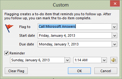

You can edit the Flag to Follow up field text each time you flag a message, but you can't save the changes permanently, or even temporarily in an MRU list. However, you can use VBA to set flags, which will allow you to save custom Flag to text, as well as custom reminder times and start or due dates.
This code sample sets a flag to "Call display-name", with a due date in 3 days and a reminder set for 2 days.
Set a custom flag for followup
To create the macro, open the VBA editor using Alt+F11. Right click on Project1 and choose Insert > Module. Paste the macro into the module and edit as needed.
You'll also need the GetCurrentItem function from Work with an open or selected Outlook item. Paste it in the module following this macro.
For more information on using VBA, see How to use the VBA Editor.
To use the macro, open or select a message and run the macro.
