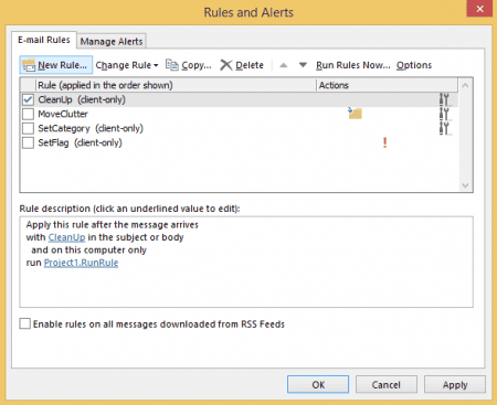

Eric had a request to run rules based on a condition, in his case, when a message with a specific subject arrives.
If I send myself a message with a specific subject line I want outlook to execute a set of predefined rules already in my outlook client.
Sure, you can do this using a Run a Script rule.
  1. Create the rules you want to run but do not enable them to run automatically.
  2. Paste the RunRules macro below into a new module in Outlook's VB Editor.
  3. Type your rule names into the olRuleNames array
  4. Create a Rule that looks for a message with your specific subject line. Select Run a Script as the Action and select the RunRules macro.
    run rules now using a macro
  5. Send yourself a test message.
