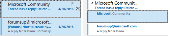

Add Messages to a Conversation
This macro adds messages to a conversation. Select the message that should be added to a conversation, hold shift and select a message in the conversation it belongs in, then run the macro.
This macro was tested in Outlook 2016 and should work in Outlook 2010 and newer. Note that it may not work with all account or data file types. It's highly recommended that you test it on a few messages first, so you can see how it works and verify it works on your account type.
Before and After running the macro:
merge threads

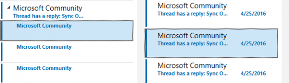

Remove Messages from Threads
This macro removes messages from a conversation. Select the message that should be removed from a conversation then run the macro. By default, the new conversation will use the message subject, but you can enter any subject.
Before and After running the macro (I added a character to the end of the subject so they would create a new thread):
split threads
