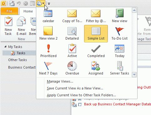

In the thread at OL10 add views to 'my tasks'> navigation pane, users are disappointed the list of views was removed from the Navigation pane in Outlook 2010. While this macro won't add the views list back, it can make it easier to switch between your favorite views.
You'll need to create one macro and one button on the QAT or ribbon for each view you want to use, so it's not practical to use with a large number of views, but will be useful for a few of your most-used views.
If you add the Change View command to the QAT (Quick Access Toolbar) accessing the lesser-used views will be a couple of steps less than using the View ribbon.
Add Current view command to the QAT
To use the macro, press Alt+F11 to open the VBA editor. Right click on Project1 and choose Insert > Module. Paste the macro into the new module, one for each button you want to create.
Make the following changes to each macro:
  • Change the macro name (Sub GetAssignedView()) so it is unique for each macro. I use the view name in the macro name.
  • Change the name of the view in each macro (Set objView = objViews.Item("Assigned")) to match the name of the desired view.
  • While Set objViews = Application.ActiveExplorer.CurrentFolder.Views allows the macro to work with the folder you are viewing, the view needs to be available for the selected folder. If it's not listed in Change Views when you are viewing the folder, it's not available.
Don't forget to check your macro security settings!
After creating your macros:
  1. Go to File, Options, Customize Ribbon or Quick Access Toolbar
  2. In Choose commands from select Macros
  3. Select your macro and click Add
  4. Repeat for each macro
Note: If you are adding the views to a ribbon, you need to add a New Group to either your most used tab or add a New Tab to add the group to.
