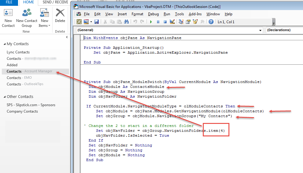

The index number in the following line controls which folder is selected when you switch to the Task Folder. This selects this second folder in the list. For example, to always use my "New Stuff" folder in the screenshot above, I'd change the index number to 5.
Set objNavFolder = objGroup.NavigationFolders.Item(2)

Use with any Navigation Module
You can use this macro with any navigation pane module by changing the 4 instances of "Tasks" to the appropriate module, folder type, or Group name.
ModuleDim as Module TypeModule Type NameDefault Group Name
TasksTasksModuleolModuleTasksMy Tasks
CalendarCalendarModuleolModuleCalendarMy Calendars
ContactsContactsModuleolModuleContactsMy Contacts
NotesNotesModuleolModuleNotesMy Notes
JournalJournalModuleolModuleJournalMy Journals
Use the code with other modules
