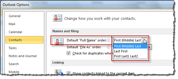

Outlook lets you set the default full name order in Options. You can choose between 'First (Middle) Last' or 'Last First' (no comma separator), as well as 'First Last1 Last2'.
Change the default name order
The traditional format of 'Last, First', with a comma separator, is also supported by default. Outlook is smart enough to properly assign the names to the correct fields when you enter a name using 'Last, First' format.

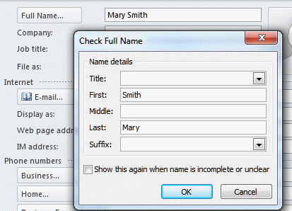

However, it's really easy to get the fields switched when you don't realize the default order is not the same order you are entering names in the full name field and aren't using a comma.
Check name dialog in Outlook
