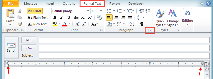

Recommended setting: keep the right margin triangle at or very near the right edge of the page (identified by red arrow). As set in this screenshot, the right margin is approximately 200 pts. If the recipient opens the message in a window 500 pts wide, the message would be indented 200 pts from the right edge.
Use ruler to check margins
Outlook doesn't have an option to set the width of a message - it uses the full width of the message window and wraps text in the window as needed. Trying to force line lengths using margins or the Enter key to break lines only results in readability problems for the recipient. It's better to adjust the width of the compose window if you need to make the lines shorter and easier to read while composing messages.
Check or adjust the margins

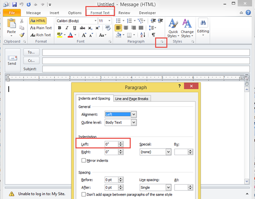

To check or adjust the margins in Outlook 2010 and up, you need to look at the Paragraph settings and Page Setup. Both the Left and Right Indentation should be set to 0 (zero).
On the Format tab, click the Expander icon to open the Paragraph dialog. (If the ruler is visible, you can point to the indentation triangles and double click to open the dialog instead.)
open the paragraph dialog
The Left and Right Indentations should be set to zero. If you want to use indentation, keep it very small. Do not use indentation or margins to make line wrap on wide screen monitors while you are composing them; this will affect the margins and format on the message the recipient receives. Adjust the width of the compose message form instead.
paragraph dialog
If you change the values, click the Set as Default button at the bottom of the dialog, then choose All documents based on NormalEmail.dotm template and click OK to commit the changes.
Save changes to template

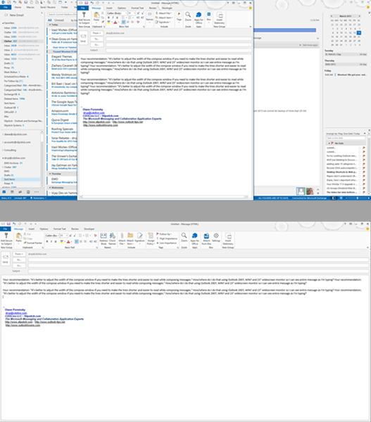

    "It’s better to adjust the width of the compose window if you need to make the lines shorter and easier to read while composing messages."
    How/where do I do that using Outlook 2007, WIN7 and 23" widescreen monitor so I can see entire message as I'm typing?

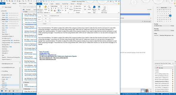

      March 14, 2015 at 3:20 pm
      Don't open the message to full screen - position it in the middle of the screen, about half the width.
      The top image is with the width of the compose window set to a comfortable reading width. The bottom is at full screen.
      Windows sizes
