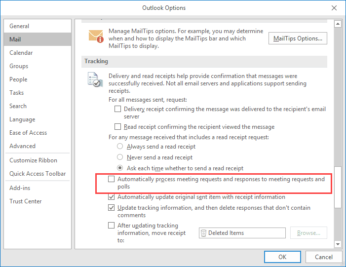

If using POP3 or IMAP accounts, you can turn off the 'sniffer'. With the 'sniffer' enabled, the meeting request is automatically added to the calendar as tentative a few minutes after arrival. When it is disabled, a tentative appointment is added to the calendar when you select or open the meeting request.
Turn off the sniffer at File > Options > Mail > Tracking section (Outlook 2010 and up) or Tools > Options > Email options > Tracking, do not select the option to process requests and responses on arrival.

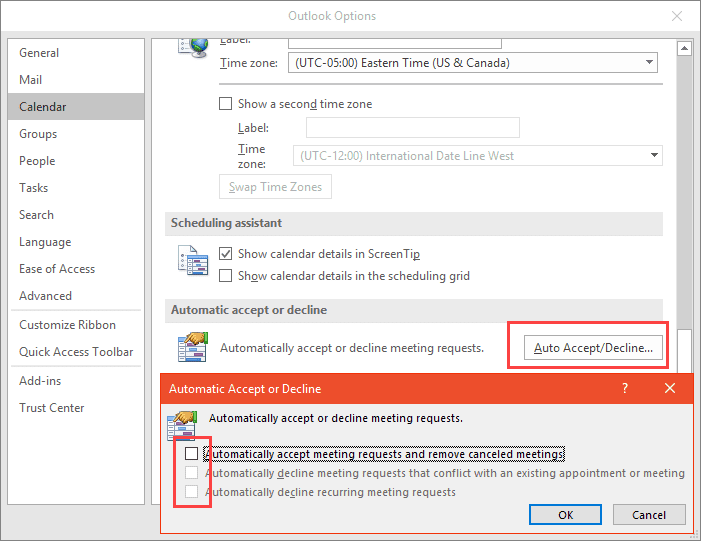

Check your autoaccept settings in File, Options, Calendar. Click the Auto Accept/Decline button and verify all options are not checked.

    May 12, 2013 at 8:46 am
    The spam appointments are getting through, despite the fact I have the box ticked off for Tracking. Thanks for the attribution on your post. https://answers.microsoft.com/en-us/office/forum/office_2013_release-outlook/has-anyone-got-a-real-fix-for-this-hole-in-outlook/7c2263b9-c264-4e52-ba77-8826064ead07
      May 13, 2013 at 4:55 am
      When you use Exchange Server, the 'sniffer' runs on the server and sets the tentative appointment. The setting in outlook applies to non-Exchange account types. Sorry.
