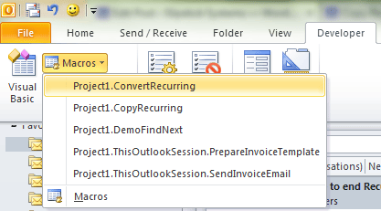

Run a macro from the Developer tab
Outlook 2010 users can customize the QAT or ribbon with a button for the macro (File, Custom ribbon or Quick Access toolbar commands) or you can show the Developer ribbon and run it from the Macros button.
In older versions of Outlook, run the macro from the Tools, Macros menu or customize the toolbar and assign the macro to a toolbar button.

Open the VBA Editor using Alt+F11. Expand the Project to display ThisOutlookSession on the left. Double click to open it and paste the code below into the right side. Select a calendar folder then run the macro.
To use, select a recurring appointment or meeting and run the macro. I highly recommend using list view when you use this macro.
