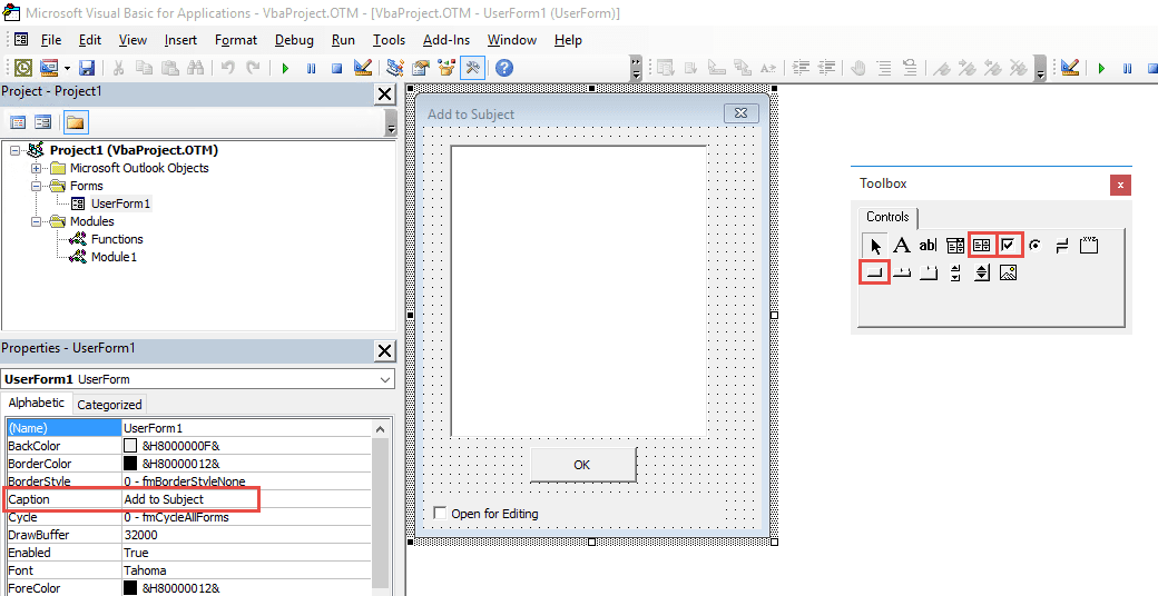

Step 2: Open the VBA Editor using Alt+F11. Right click on Project1 and choose Insert > UserForm to add a UserForm to the VBA project. If the Toolbox isn't visible, go to the View menu and select Toolbox. Drag the edges to resize as needed. Change the Caption in Properties.
add the userform and change the caption

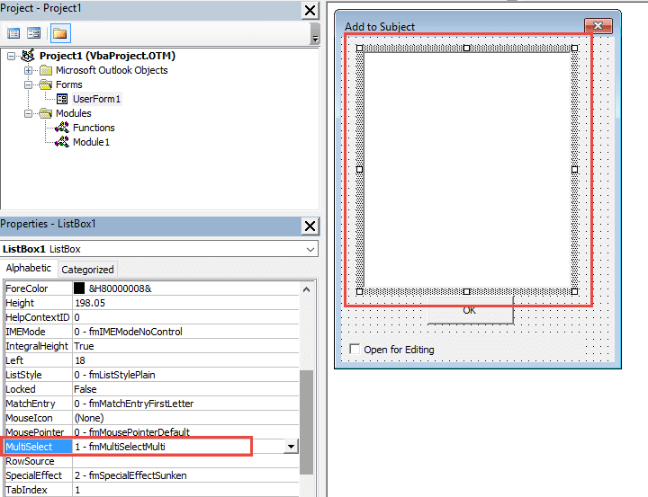

Add a Listbox to the form and drag to resize it. In the Properties screen, find MultiSelect property and change it to allow multiple selections, otherwise you'll only be able to select one entry at a time.
change the multiselect property
Drag the CommandButton control to the Userform. Change the Caption to Ok in Properties.
If you want to open a selected message to type keywords (eg, to add project numbers) add a Checkbox control and change the Caption.
