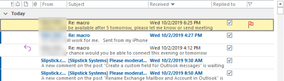

A user wanted to know how to mark messages they had responded to. One method is flagging the items complete.
Another is to add a custom field to add check boxes to the row so that you can mark the messages. Then you can use automatic formatting and filters to show or hide the marked messages.
You can even create a custom text field and write notes about the message.
To create a custom field:
  1. Open the View Settings dialog from the View ribbon. In Outlook 2007 and older, its Customize view and you can right click on the header row above the message list and choose Custom or Customize View (Outlook 2007 and older) from the bottom of the menu.
  2. Click Columns to open the Show Columns dialog.
    view settings dialog
  3. Click New Column button.
    click New field
  4. Create a custom field of the Yes/No type and add it to the view.
    create a new field
  5. Click Other Settings.
  6. Enable in-cell editing so you can check (or uncheck) it to mark an item.
    allow in-cell editing
  7. Return to Outlook.
  8. Click in the column you just added to mark a message
    custom field in view
Note: The actual checkbox may not be visible in the column until you click it.

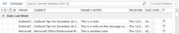

Create a notes field for messages
To create a field so you can add notes to the messages, you need to create a Text field and enable in-cell editing. Use the same steps as above, choosing the Text field type instead.
Add a custom notes field to a message
The following video tutorial shows how to create a custom field in Outlook 2010 and newer.
Use a Macro to add a Notes Field
This macro brings up an Inputbox for you type the note in then adds it to the selected message. If the field already exists, the contents are shown in the inputbox, so you can edit it or type over it to replace.
use an inputbox to edit a field
