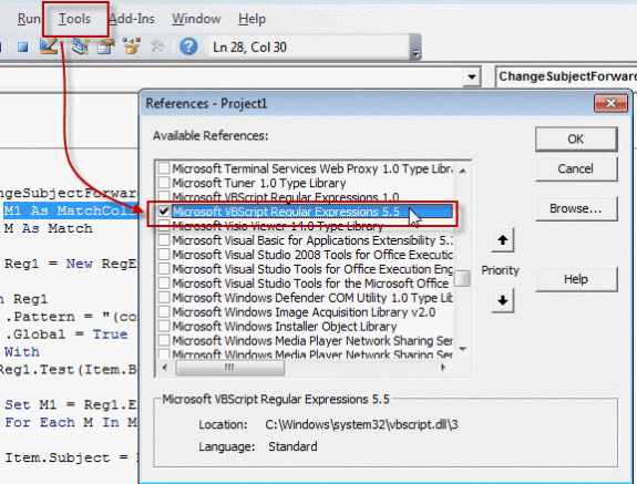

To use this code sample, open the VBA Editor using Alt+F11. Right-click on Project1 and choose Insert > Module. Paste the following code into the module.
You'll need to set a reference to the Microsoft VBScript Regular Expressions 5.5 library in Tools, References.
Set a reference to VBScript Expressions
Note: if VBScript Expressions 1 is selected, deselect it. You can't use both v1 and v5.5.

    I think this is exactly what I am looking for, but I don't have Microsoft VBScript Regular Expressions 5.5 as an option under "References", using Outlook 2016. Am I doing something wrong?
      September 21, 2016 at 8:23 pm
      Type N in the list so it jumps down the N's then scroll up a little. if its really not there, see if c:\windows\syswoe64\vbscript.dll exists.
      references dialog
