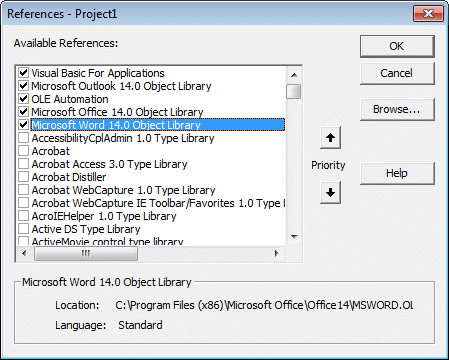

Set References
You need to go to Tools, References (in the VBA Editor) and add Word as a reference.
In this screenshot, it lists Word 14. If you use an older version of Word, you'll have a different version here.
Set the VB references
