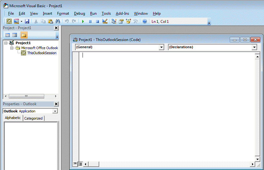

  1. Paste the code into the VB editorPress Alt+F11 to open the VBA editor. (or Tools, Macro, Visual Basic Editor)
  2. Expand Project1 then double click on ThisOutlookSession to open the code window.
  3. Copy the code above (click in the text, Ctrl+A to select all, Ctrl+C to copy)
  4. Paste it into the code window then Save.

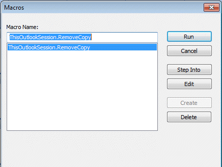

  5. Press the Run button.
To run the code later, press Alt+F8 (or Tools, Macro, Macros), select the RemoveCopy macro and press Run.
Use the Macro dialog to run macros at any time.

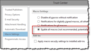

    for some reason even if I enable all macros in the trust center it won't run the VBA macro :(
      June 7, 2017 at 10:02 pm
      Any error messages? What happens when you try to run the macro? Did you previously sign the macros? (Remove the signature if so).

    I can't get Outlook 2013 to allow me to run the VBA. I enabled all macros in Outlook Trust Center as you recommended but when I click Alt F11 it does nothing. I do not get any project screen or VBA editor. Is there some other setting I need to change?
    • Jfan says
      September 10, 2015 at 6:13 pm
      Hi Diane. Never mind - I figured it out. User error. Thanks for the information! Worked great.

    after enabling macro's in trust center, the vba script worked as expected. took a few minutes but I don't have that many appointments. For someone with a full schedule I would not be surprised if this took half an hour or more

      Ok... i think i figured it out. Maybe. In Outlook, check the Macro settings in the Trust center - are you sure its not list as seen in the screenshot i posted earlier?
      Can you exit the VBA Editor or is the macros disabled error keeping you from exiting?
