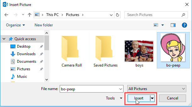

Create a signature with an image
  1. In File, Options, Mail, click on Signatures to open the Signature editor.
  2. If you have a signature you want to add an image to, select it, otherwise click New to create a new signature.
  3. Position the cursor where you want the image then click the Picture button on the right.
  4. Select the picture and click Insert to insert the image as an embedded image. This will include the image as an attachment.
  5. If you want to add a hyperlink to the image, click the Hyperlink button. Note: The inserted image should be selected immediately after inserting it, if you add a hyperlink later, you'll need to select the image first.
Images added to signatures using the steps above will embed the image as an attachment. In some mail clients, the recipient may see the attachment icon, but Outlook and many other mail clients will render the image in the signature and hide the attachment icon.

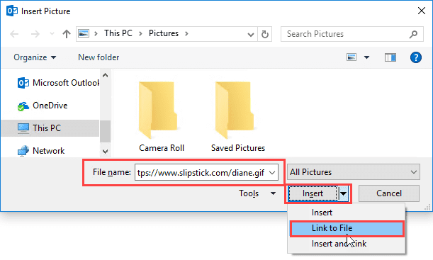

Create a signature with a linked image
If you prefer including a linked image on public web site, Outlook 2013 and up make it easy to create signatures that link to images on the web.
Warning: if you are using an image on your local computer, choose Insert to embed the image. Otherwise, Outlook will send a link to a file that may not exist on the recipient's computer.
  1. Open the Signature editor and create a new signature (or select an existing signature)
  2. Click on the Picture button
  3. Type or paste the URL to the image in the Filename field.
  4. Expand the Insert button and choose Link to file
After adding the image, add a hyperlink to the image by selecting the Hyperlink button and entering a URL to a web page. (If the image is not selected, you'll need to select it first.)

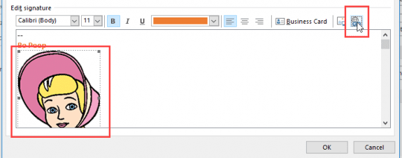

Create a signature with an image tutorial
  1. Place the cursor in the signature at the location where you want the image.
  2. Click the Insert image insert imagebutton.
  3. Select and insert the image.
  4. With the image selected, click the Insert hyperlink insert hyperlinkbutton.
  5. Type or paste the url into the Address field.
  6. Save the signature.
This video shows how to add an image to a signature and hyperlink it. When the image is added to the signature using this method, the image is included in the message as an attachment.
