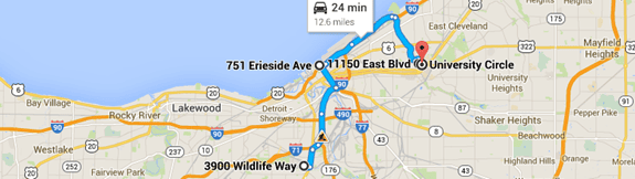

Map Multiple Addresses or Locations
You can get directions to multiple addresses using Google Maps with a URL formatted like this: https://www.google.com/maps/dir/street+city+state+zip/street+city+state+zip.
Use Current+Location to begin at your location or add your address as the first string. https://www.google.com/maps/dir/Current+Location/street+city+state+zip/street+city+state+zip.
I'm using a select case statement so we can use one macro for both appointments/meetings and contacts. I'm also using an If Statement to get a home address if the business address doesn't exist.
To use, select the contacts in first stop to last order and run the macro. Appointment locations are mapped first appointment to last. It works with any calendar or contacts folder in your profile.

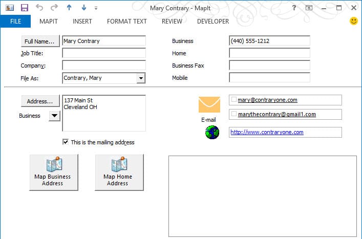

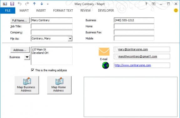

To add buttons to map Home or Business address, use this code and two buttons, one called cmdMapBiz, and the other cmdMapHome.
custom form with map buttons
To create this form, I added pictures to labels (in the label's Advanced Properties) and renamed them cmdMapBiz and cmdMapHome. (I also added pictures to the email and web address labels.)
Dim strAddress
Sub cmdMapBiz_click()
strAddress = item.BusinessAddressStreet & "+" & item.BusinessAddressCity & "+" & item.BusinessAddressState
strAddress = Replace(strAddress, " ", "+")
MapAddress
Sub cmdMapHome_click()
strAddress = item.HomeAddressStreet & "+" & item.HomeAddressCity & "+" & item.HomeAddressState
MapAddress
Sub MapAddress()
Set Shell = CreateObject("WScript.Shell")
strURL = "//maps.google.com/maps?f=q&source=s_q&hl=en&geocode=&q=" & strAddress
Shell.exec("C:\Program Files (x86)\Google\Chrome\Application\chrome.exe" & " " & strURL)
