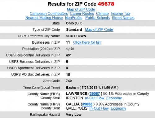

The following two URLs work for US addresses. Any site that includes the zip code in the URL can be used. To use, replace the number with the zip code string. Melissadata's URL accepts the full telephone number or just the area code, if you prefer to use it.
https://www.melissadata.com/lookups/ZipCityPhone.asp?InData=12345&submit=Search
//www.zip-info.com/cgi-local/zipsrch.exe?tz=tz&zip=12345&Go=Go
At this time, the code opens a web page containing the time zone and other information.
results from melissadata
I'm working on scraping the page and grabbing just the time zone from the page, then displaying it in a message box, writing it to the notes field, or to a custom field.
