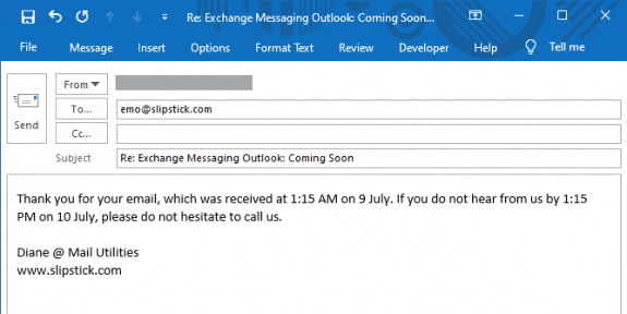

These code samples show you how to use a run a script rule to send an auto response, including the received date and when the recipient should expect a follow up response. The first sample uses a template for the reply, the second macro replies to the incoming message.
autoreply with dates
Autoreply using a template
This macro sample uses a template with fields that will be replaced with the date and times. A template is easier when you want to reply with a longer message. If you have a signature added automatically, remove the signature from the template before saving it.
template sample

Autoreply to the message
This example has the response in the macro and inserts the time and date into the response string. This method works better if you are inserting a shorter response.
At the end of this macro is a small "stub macro" so you can test the macro on a selected message, rather than sending and receiving messages to test it.
auto reply sample
