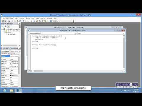

Step 1: Create the Userform.
  1. Right click on Project1 and select Insert > UserForm
  2. Open the control Toolbox and select a ComboBox and add it to the UserForm.
  3. Add a Command button.
  4. Right click on the Command button and choose Properties.
  5. Type OK (or Change Subject) in the Caption field.
  6. Right click on the UserForm and choose View Code.
  7. Paste the code below into the code window.
  8. Change the subject titles as desired. This list is for your reference only, not the actual text that will be added to the subject. The subject text is changed in the VBA macro code.
Private Sub UserForm_Initialize()
  With ComboBox1
    .AddItem "Subject 1"
    .AddItem "Subject 2"
    .AddItem "Subject 3"
    .AddItem "Subject 4"
    .AddItem "Subject 5"
    .AddItem "no change"
Private Sub CommandButton1_Click()
    lstNo = ComboBox1.ListIndex
    Unload Me

Video Tutorial
