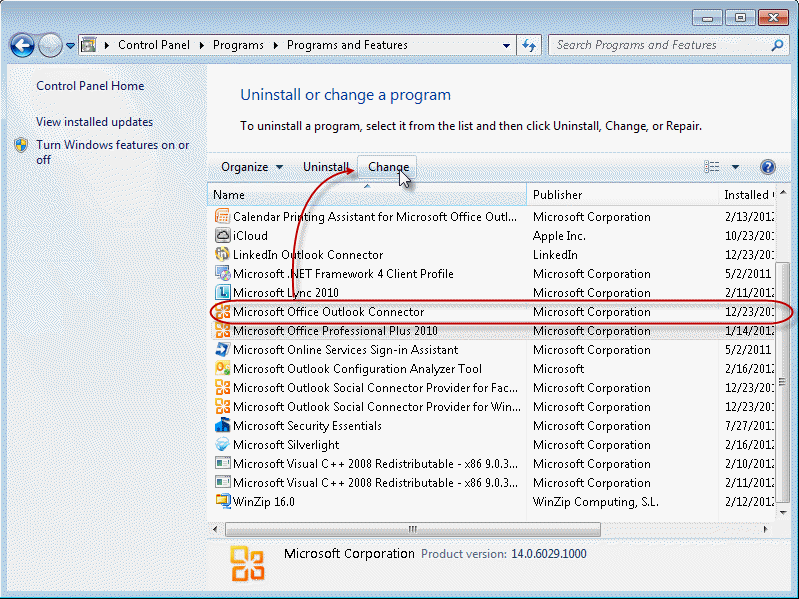

To start the repair process, open Window's Control Panel and locate Add or Remove Programs under Programs and Features. If you are using Windows 7 Category view of the Control Panel, choose the Uninstall a Program link under Programs category. In all versions of Windows, you can also type add remove programs in the Search field to find Add or Remove Programs.
Once Add or Remove Programs is open, locate your Office 2010 or Outlook 2010 standalone installation in the list of installed programs and select it. Then click the Change button. In Windows 7, it's at the top of the list. In Windows XP, it will be to the right of the Office entry.
Windows 7 Control panel's Add or Remove Programs dialog

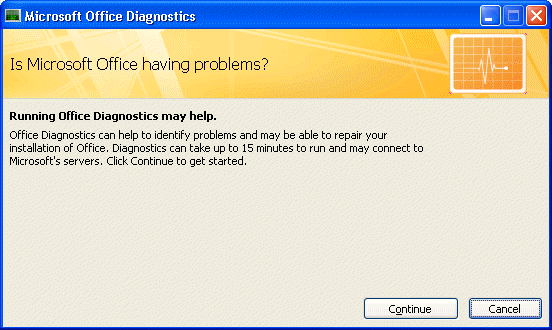

The Office Diagnostics wizard opens. Click Continue to begin.
Use Office diagnostics to fix some problems

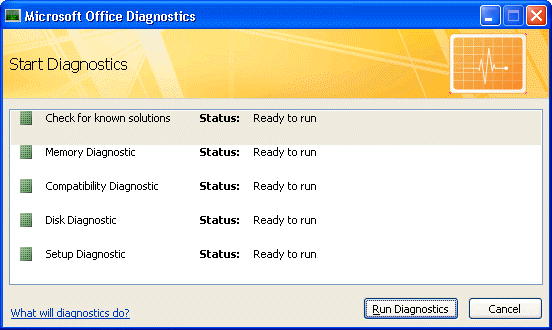

The next screen shows you everything the diagnostic routine checks. Click Run Diagnostics to begin.

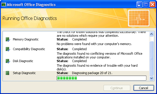

While the diagnostics are running, the dialog updates with the results:
Office Diagnostics results

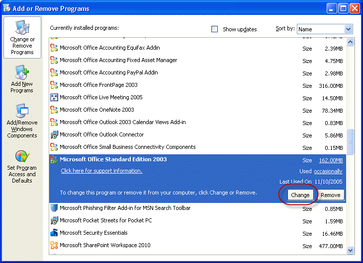

To repair the installation by reinstalling it, insert your Office 2003 CD then go to Control Panel and click on Add or Remove Programs. Locate the Office or Outlook installation in the list of installed programs and click Change. (If you are using Windows 7 Category view of the Control Panel, choose the Uninstall a Program link under Programs category.)
Locate Outlook in Add and Remove Programs and choose Change
