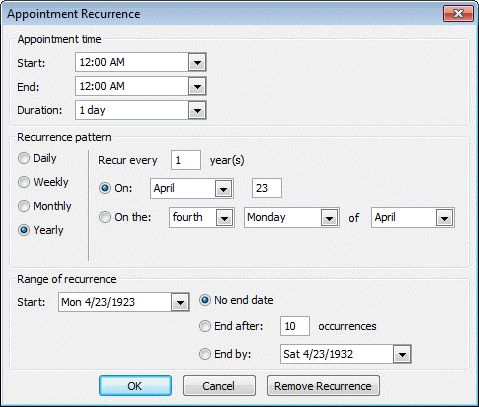

In this calendar sync bug, All Day events that recur yearly are changed to recur every 12 years. This bug first appeared with the release of Office 2007 SP2 and affects devices that sync with Outlook 2007 using ActiveSync. It may only affect users who sync their device between two different computers.
The problem is related to Outlook's ability to set an appointment's recurrence to "every N years".
Recurrence options
This recurrence setting was added to Outlook beginning with Outlook 2007 SP2 but this recurrence pattern is not supported by Window Mobile's calendar.
