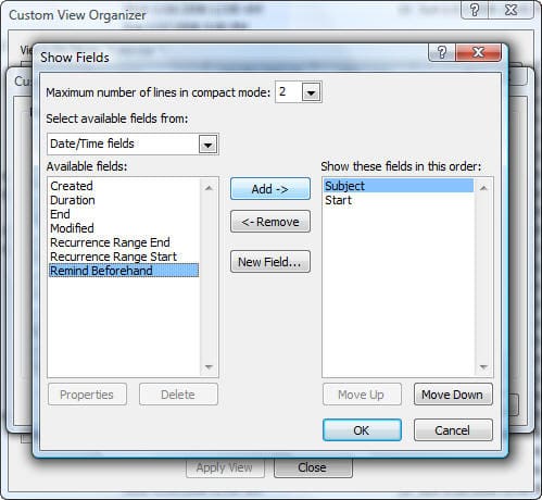

  4. Remove any fields you don't need in the view or print out and Add the Remind Beforehand field.
  5. add field to a view
  6. Click the New Field button.
  7. Enter a name for the field and select Formula from the Type drop down (or press the F key after tabbing out of the name field)
  8. Create a new custom field
  9. Type or paste the formula in the Formula field and click Ok.

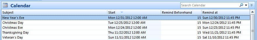

The finished view

Carl's Birthday    Mon 4/23/1923 12:00 AM    15    Sun 4/22/1923 11:45 PM
As with anything recurring, this only works as expected for the first occurrence, but it works as expected for individual appointments. Oh, and it won't show the new reminder time on snoozed reminders.
