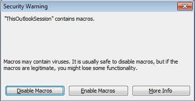

How to use this macro
Using a macro in Outlook, short version:
  1. Step 1: Enable macros in Tools, Macro Security or Tools, Trust Center (Outlook 2007). We recommend the 'warn for all macros' setting (Medium in Outlook 2003 and older). With this enabled, you'll need to allow macros each time you start Outlook. In older versions of Outlook, you may need to close and restart Outlook before the macros will work.
    Allow macros to run
  2. Step 2: Open the VBA Editor using Alt+F11 keystroke.
  3. Step 3: Expand the Project menu and select ThisOutlookSession
  4. Step 4: Copy and paste the macro into ThisOutlookSession. The text should be blue, green and black. Red text means there is a syntax error in that line.
  5. Step 5: Save (Ctrl+S or Save button). Note: you'll need to save the VBA project when you close Outlook too.
