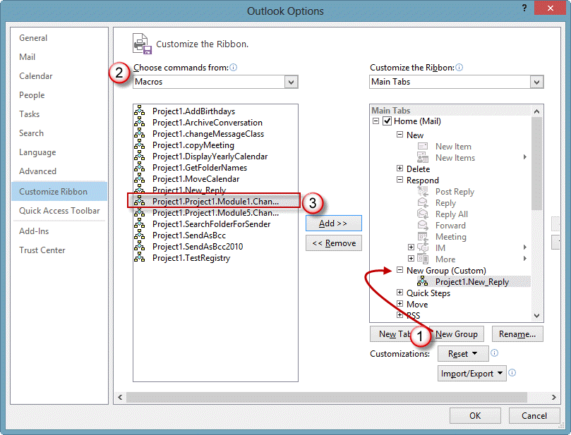

To create buttons for the forward macro:
In Outlook 2010 and above:
  1. Go to File, Options, and choose Customize Ribbon.
  2. Add a New Group to the list on the right side then Add the macro to the new group.
    Create a macro button
  3. Select Macros in Choose Commands from.

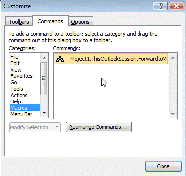

In Outlook 2007 and older:
  1. Right click in the toolbar area, choose Customize.
  2. Switch to the Commands tab.
  3. Select Macros under Categories.
    Customize toolbar
  4. Drag the macro to anywhere on the Toolbar.
