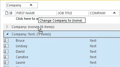

  4. Drag all of the contacts from the "wrong" group to the !Test group by grabbing the group header and dragging it to the !Test group.

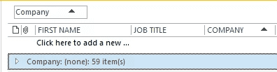

  5. Drag the !Test group header to the remaining 'none' group and drop it on the group header. The screentip will say "Change Company to None".
    drag contacts to group
  6. If you have a lot of contacts in a group it may take a few seconds for Outlook to change the company name, but otherwise, it doesn't take much effort.
    one Company (none) group
