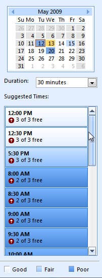

Suggested Times
How it works: After adding the attendees to the meeting request, Outlook reads the attendees free/busy and populates Suggested times with the best times available on the selected date, listing the time and number of attendees who are available in that time period, sorted by the time periods with the most attendees available.
The suggested times are supplied by the Availability service in Exchange 2007, so you'll only see it if you connect to Exchange 2007 (or higher). If you use Exchange 2003 or earlier, the old "AutoPick Next" feature still works. Fortunately, Outlook is smart enough to know which feature your version of Exchange supports and displays it to users.
The scheduling assistant grid displays the selected date, showing everyone's availability. Click on any time under Suggested times and the picker moves, just like it does with Autopick.
Availability iconsIf the selected date isn't going to work, pick another date in the thumbnail calendar. It's color coded to make it easier - white means best availability, darkest blue means there are few periods where all attendees are available. When you select a date in the thumbnail calendar the suggested times for that date fill the Suggested times pane and the scheduling grid jumps to that date, displaying the attendees free/busy. Just like Autopick.
