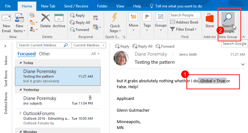

With this macro, you select the word or phrase then click the button on the ribbon:
select the phrase and run the macro

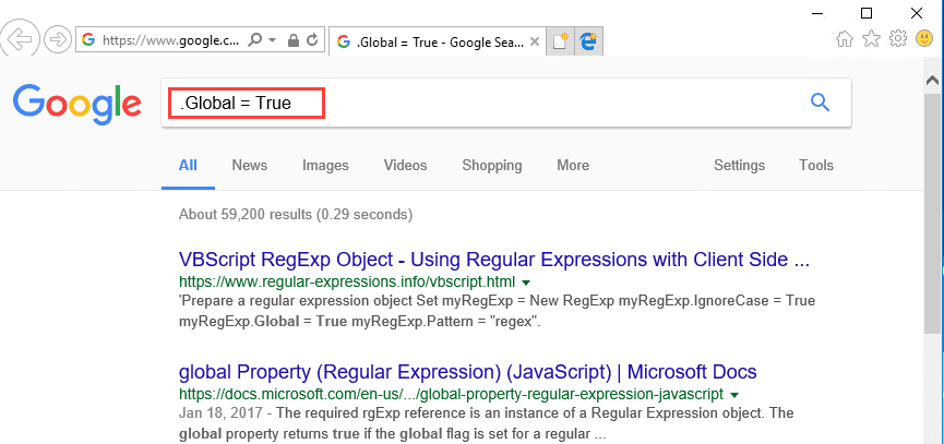

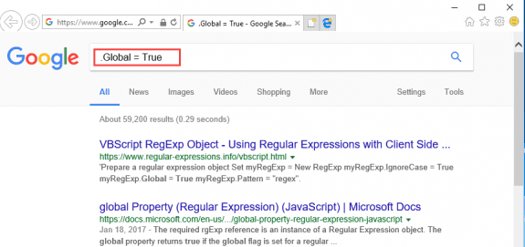

The selected text is sent to the search engine:
search results

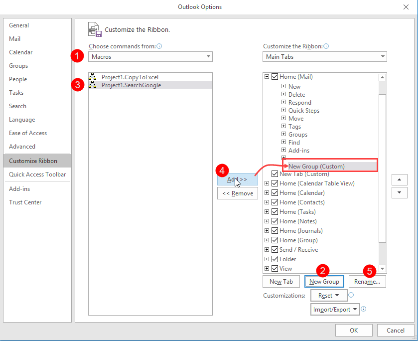

Add the macro to a button on the ribbon
  1. Open File, Options, Customize Ribbon
  2. Select Macros from the Choose commands from dropdown (1)
  3. Add a New Group to the ribbon (2)
  4. Select the Search macro (3)
  5. Click Add to add the macro to the new group. (4)
  6. Click Rename to give it a friendly name and an icon. (5)
If you prefer using the Quick Access Toolbar, add a macro button to it instead.
