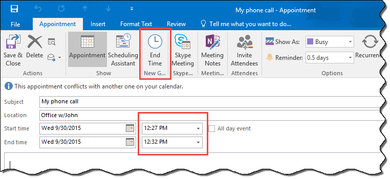

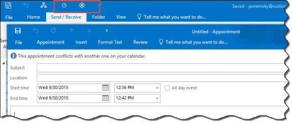

What if you want to take notes during the meeting or phone call? In that case, you can open the new appointment form first then use a macro to set the end time after the meeting ends. Add the Start button to the main Outlook ribbon or QAT and the End Time macro to the Appointment form's ribbon or QAT.
Create an appointment for Now to use as a diary
You don't actually even need a macro to do this, although it does save a few steps over the manual method:
  1. Open Appointment form
  2. Type Now in Start time field then tab out.
  3. When meeting ends, type Now in End time field then tab out.
Dim oAppt As AppointmentItem
Sub ApptStart()
Set oAppt = Application.CreateItem(olAppointmentItem)
With oAppt
  .Start = Now
  .End = Now
  .Display
Sub ApptEnd()
oAppt.End = Now
