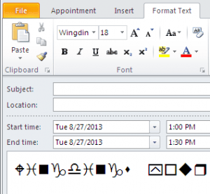

I'm starting with Michael Bauer's Inspector: Edit new items code sample and adding a few lines to set the font. Now when I open any new Outlook item (but not a new message or sticky note), the body font is changed. In my example (so we can easily see that it works), I'm using Wingdings (and size 18 font). Replace it with a font name as seen in the Font selector. (You can use lower case names as the font name is not case-sensitive.)
Use VBA to change the font in new items
This is an Application_Startup macro. Paste it into ThisOutlookSession and set a reference to the Microsoft Word Object Library in Tools, References. To test it without restarting Outlook you'll need to click in Application_Startup and click the Run button. Oh, and macro security needs to be set to Low during testing and the macro signed once you're satisfied with it. How to use Outlook’s VBA Editor has more information if you are new to VBA.

Change the font for only one item type
If, like Martin, you only want to change the font for one Outlook item type, the If... then statement looks for the item type and changes the font. Other types are not touched.
Replace the m_Inspector_Activate() sub with the following code:
