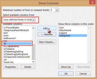

Switch to a list view then run the macro. Add the TZ field to the view. In Outlook 2010 and above:
  1. Click View Settings button (View tab)
  2. Click Columns
  3. In Select available columns from dropdown, select User-defined fields in folder.
  4. Select TZ field and click Add.
    Add the field to the view
  5. Close the dialog and return to Outlook.
  6. Right click on the TZ field and choose Group by this field.
  7. If you need to delete the appointments, select the Group name and press Delete.
