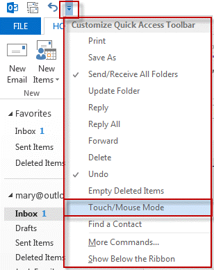

To check out touch mode, expand the Quick Access Toolbar menu and select Touch Mode. This adds the Touch Mode button to the QAT which you can use to toggle Touch Mode off and on.

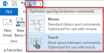

Select Touch/Mouse to enable the menu
Switch between touch and mouse mode

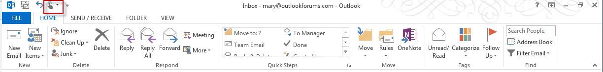

Although it's less than useful if you don't have a touch screen, if you like the roomier ribbon, you can use it with a mouse. If you like the Delete button in the message list, you'll want to stick with mouse mode unless you are using a touch screen.
This screenshot shows the Home ribbon in "normal" mode. The Touch Mode button was added to the QAT and is highlighted.
Outlook 2013 ribbon in normal mode, with Touch mode button highlighted

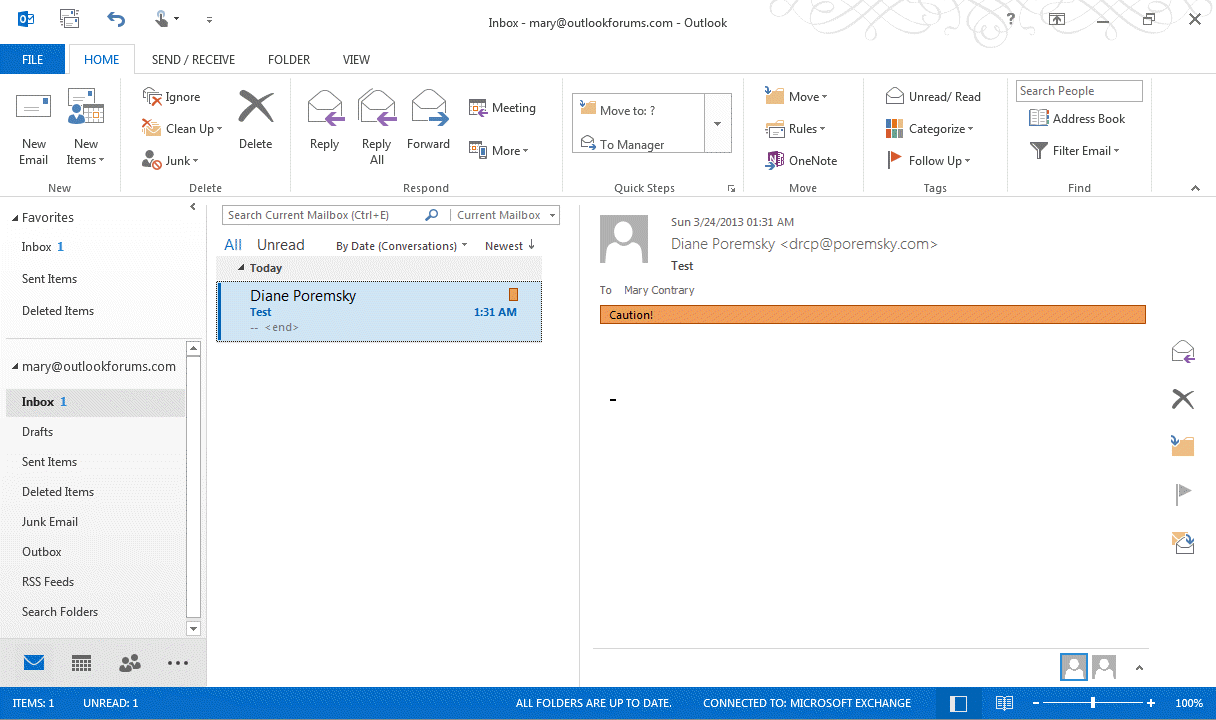

Touch Bar
When Touch Mode is enabled, a toolbar is added to the right side of the screen (see screenshot below) and the ribbon is roomier. I like the Quick Steps menu (especially on a window wider than I used for the screenshot.)
The Quick Delete, Mark as Read bar, and Flag buttons in the message list cannot be selected by touch, you'll need to use the icons on the Touch bar instead.
Touch mode is enabled, showing extra toolbar and roomier buttons
Use the touch bar on a tablet to reply (flyout includes reply all and forward options), quick delete, move or copy to folder, flag for followup, or mark messages read and unread.
